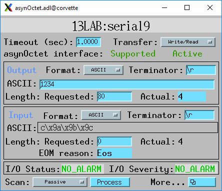

I tested with my VxWorks system in the sector 13 electronics lab today.  I reproduced the behavior Mrinal is seeing.  This is all different hardware from Mrinal’s.
I put a loopback from pin 2 to 3 and used the asyn record to send a string and read the response.  It works fine with the following baud rates:
2400
4800
9600
19200
38400
300, 600, and above 38400 report that the baud rate is not supported on the VxWorks console.
1200 does not report that it is unsupported, but the readback is incorrect, it does not match the output.
If 1200 was previously working at APS beamlines then we need to figure out if there was a change to the driver that broke it.

Although the RS-232 settings for Lakeshore 330 are (Baud rate:1200bps, Parity: Odd, Stop bits:1, Data bits: 7), I tried to test the loopback with your suggestions (data bits: 8, parity: none), and got different input/outputs for 1200 baud rate as shown in the attached image. With 2400 and above baud rates the input/output values are the same as expected.

While configuring RS-232 communication through XM-octal breakout boards with TVME-200 (with IP-Octal serial module) and MVME3100 using EPICS 7.0 and vxWorks-6.9.4, I did some quick tests with asynRecord. I found the following:
1) With loopback communication(when I sorted the 2 and 3 terminals of the RS-232 ports) with the baud rates of 2400 and above, I received the same input and output values (as shown in the 1st attached image). That shows that RS-232 communication is OK.
2) With the baud rate of 1200, the Output and Input values of asyRecord are different (as shown in the 2nd attached image). I suspect either the tyGSModule or TVME-200 with IP-Octal Serial board has some issue with communication baud rates below 2400.
