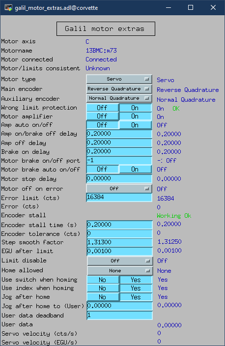

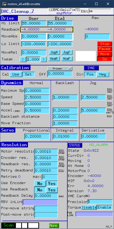

I am working on axis C on a Galil 4183 with the D3140 servo amplifier unit installed.
I have attached a screen shot of the motorx_all screen (Galil.png).  I have also attached a screen shot of the galil_motor_extras.adl for this axis (Galil_extras.png).
The axis is configured as Servo with Reverse Quadrature encoder.  (The problem happens with Normal Quadrature as well).
In the motorx_all screen I have set Use Encoder=Yes (UEIP field).  I put the axis in Set mode and type 0 into the VAL field.  VAL, DVAL, and RVAL all set set to 0 as expected.  However, RRBV, RBV, and DRBV do not change, they are the same encoder readback as before I set the position.
  • Ensure dual feedback mode is off with DFx=0.
I have done that.
  • I recommend checking if the value is written to the hardware correctly by using Galil commands DEx=?, DPx=? (where x is the motor in range A-H).
DEC=? returns 0, but DPC=? returns -4000, so the encoder value was not written to the hardware.
