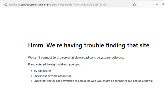

  1. I am trying to get CSS from https://www.controlsystemstudio.org/download/ , but website not working. Is it possible to get it windows package from anywhere else ?

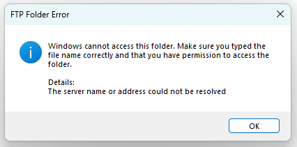

  1. For widows Alarm Handler ftp://ftp.aps.anl.gov/pub/extensionsStatic/win32/ this also doesn’t seem to work for me. Any other source
