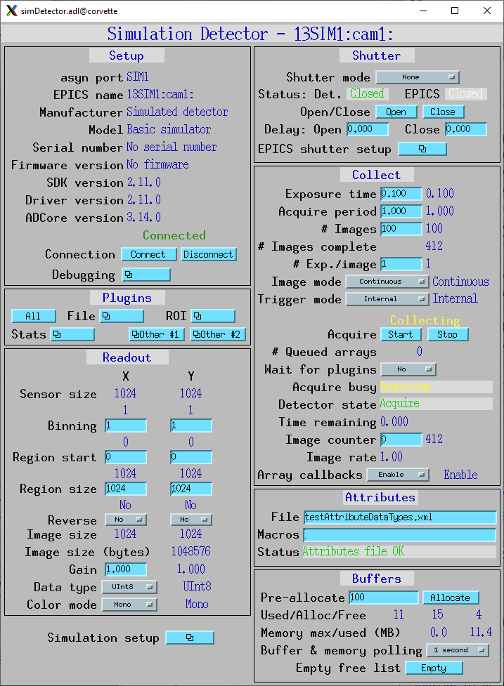

I just tested what you are trying to do with 3 ADSimDetector drivers running in the same IOC.  It worked fine.
I set each simDetector with AcquirePeriod=1 second, Continuous acquisition.  See first attachment.
