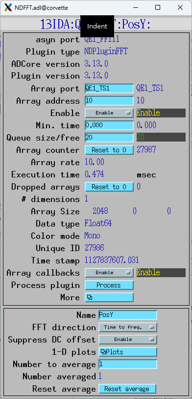

The first thing to do is open the detailed screens for that FFT plugin.  This is what I see with “More/FFT plugin”.  Note that Array rate=10 Hz, the execution time is 0.474 ms, and the array counter is incrementing at 10 Hz.  Are these values updating on your screen?
This is what I see when I press the More/NDPluginBase Full”  on the screen above:
