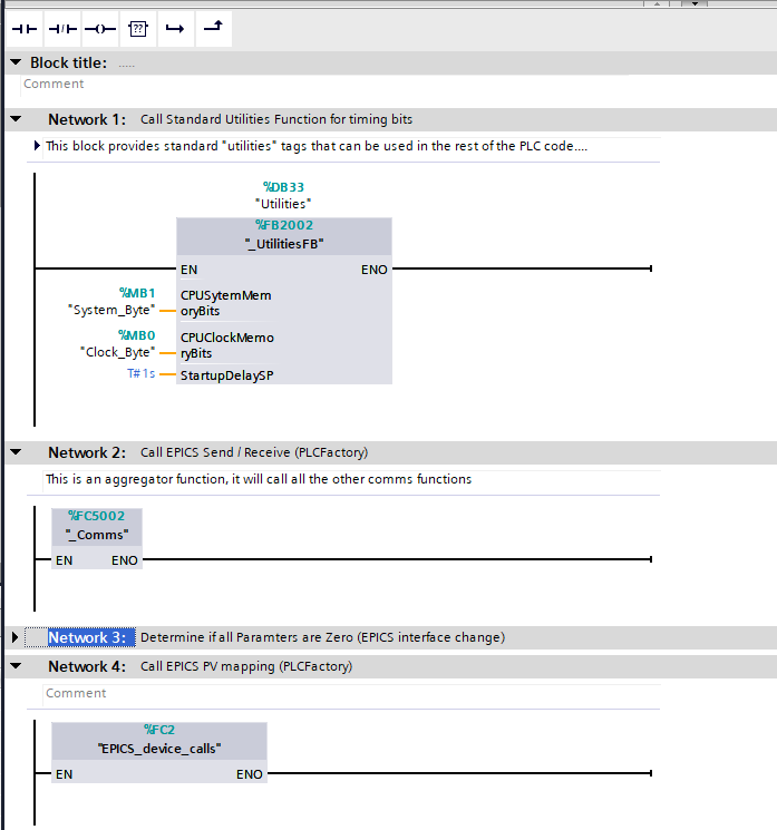

I made an example project including:
  • An e3 IOC with several variables sent and received.
  • Run script to run the IOC
  • Also attached the PLC code for TIA15.1 that talks with this IOC.
So this IOC talks with the PLC code I have attached.
I have some extra features in my IOC-PLC communication such as Hash checking and heartbeat check, communication diagnostics and several other, that won’t make it easy to you to understand the db file, but I hope it helps.
For the PLC part, import the scl files attached with External source option.
First the PLCFactory_external_source_standard_TIAv15.1.scl and than the PLCFactory_external_source_TIAv15.1.scl.
Call these blocks from OB1.
Before you call Utilities  make sure to have the clock memory and system memory byte enabled.
Also be aware that the _UtilitiesFB instance already exists in the External source input, so when you call the Utilities FB as above, don’t generate a new instance, but select the _UtilitiesFB.
I hope it helps.
