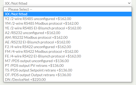

I know very little about these controllers.  But looking at the catalog here https://eurothermonline.com/controllers/eurotherm-2408.html for one model, it seems that the communications option is specified when ordering, and there are lots of choices like RS-485 BiSync, RS-484-Modbus, RS232-Modbus, etc.  See attachment. Are you sure how yours is configured?
Mark

The above 2 lines do not look internally consistent to me.  The first line says you are using a serial port for communication.  The second line says that the link type (second argument) is 0, which is Modbus TCP.  Normally when you communicate over a serial link type needs to be 1=RTU or 2=ASCII.
Mark
