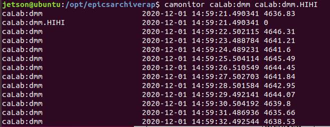

I think that is what is most confusing, not sure why the archiver table is showing connected and then the details has much different status.  I am able to do camonitor but was wondering about the HIHI field you mentioned.  I thought that field is only needed for the alarm config on an ai record?
@Han
I will check out our previous discussion, I know you mentioned the environment variables and got some responses.  I currently have my laptop at 192.168.40.100 and the PXIe chassis at 192.168.40.200.  I am listing the EPICS_CA_ADDR_LIST=192.168.40.200 in archappl.conf.

I have been successful in getting the epics archiver appliance to archive PVs that are running in soft IOCs locally on the same machine as the archiver.  But now I tried to archive an IOC that is running on a subnet 192.168.40.x and it is says its connected/archiving but it never pushes to STS. It does show the details from the record for caLab:dmm shown below, which seems like its able to read from it. Settings for archiver appliance.xml below and also the archappl.conf environment variables set for the subnet to be seen.  I am able to also use caget through cmdline to get values from caLab:dmm and CSStudio is able to monitor them but the archiver doesn’t seem to be actually saving the data.
