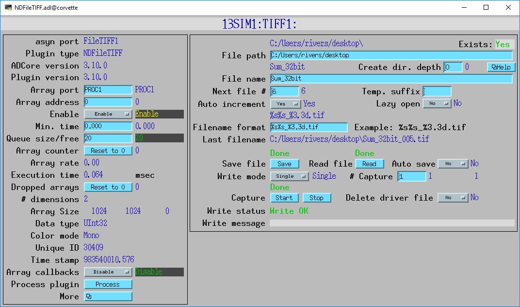

I don’t understand what the problem could be.  It works fine for me.  Here is a screen shot:
Note that I entered the FilePath using forward slashes “/” just as you did.  Because I did not enter a final “/” the plugin added a backslash “\”, which is what it should do, and it did this for you as well.
I don’t get any error, it is working OK for me to save files.
