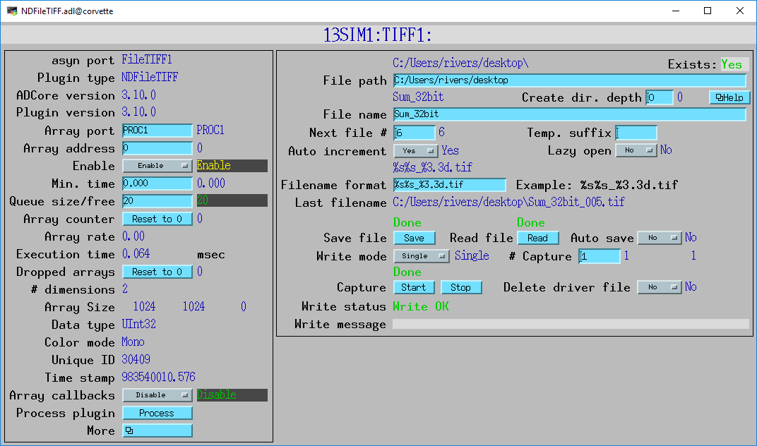

I don’t understand what the problem could be.  It works fine for me.  Here is a screen shot:
Note that I entered the FilePath using forward slashes “/” just as you did.  Because I did not enter a final “/” the plugin added a backslash “\”, which is what it should do, and it did this for you as well.
I don’t get any error, it is working OK for me to save files.
The only thing that looks unusual to me is that in your error message it seems to be replacing C: with a Chinese character.  I don’t know enough about how Windows handles other languages to know if this might be a problem.  Perhaps the areaDetector code is not treating such characters correctly.  Is it possible to try some other location that would not have a Chinese character in it?
