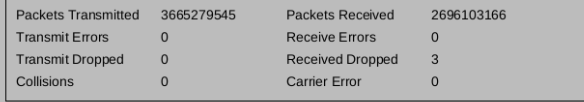

There is IOCMON from PSI that contains some network statistic support for VXWorks: http://epics.web.psi.ch/software/iocmon/
We at ALS are using a similar idea from this to monitor network statistics on our linux servers. A colleague worked on that and we can discuss that more or share the code. We don't have disk space stats but that would be interesting.
To address the PV duplication, we ended up separating the existing iocStats database into 2 separate files. An "IOC-specific" stats database and a "System-specific" database. Then for each of our soft IOC servers, we have one dummy soft IOC that simply loads the system stats database.
