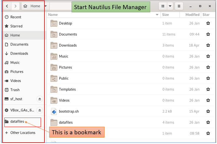

After the external application is started up through the “Execute Command” action of an ActionButton, everything looks to be working well, but when doing the save/open businesses through the external app interface, it seems that the current user File Manager configuration is not being honored, e.g. you cannot see any bookmarked locations on the pop-up file/directory open dialog (see Figure 1 and 2 for the comparison), which the user does not expect, and to some extent, affect the productivity.
Figure 1: File Manager opened from the external app
Figure 2: File Manager opened from the Linux system
