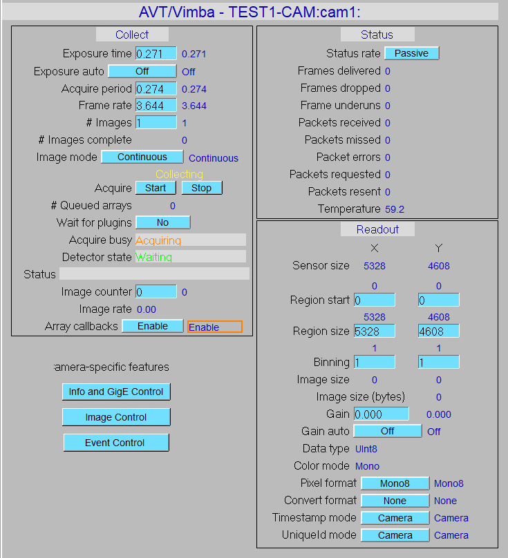

I have Allied Vision Alvium G1-2460m Camera and using ADVimba driver to interface the same. I can write/read all other camera parameters but can't see image streaming (the array counter is not running up). I have followed this link to create template files. I get this message on IOC start
2022/11/14 05:13:00.331 Param[ACQ_PERIOD] GenICamFeature::write: node AcquisitionFrameRate is not writable
2022/11/14 05:13:00.359 Param[GC_FRAMERATE_ENABLE] GenICamFeature::write: node AcquisitionFrameRateEnable is not writable
2022/11/14 05:13:00.387 VimbaFeature:writeEnumIndex: ERROR calling SetValue error=-11
The contents of st.cmd are

FYI, The software trigger source is selected which should capture the frame on every software trigger. Detector state is always in waiting state. I have attached opi screenshot to confirm that camera interface works well. Any suggestions would be appreciated.
