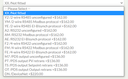

Hi Michael,
I know very little about these controllers.  But looking at the catalog here https://eurothermonline.com/controllers/eurotherm-2408.html for one model, it seems that the communications option is specified when ordering, and there are lots of choices like RS-485 BiSync, RS-484-Modbus, RS232-Modbus, etc.  See attachment. Are you sure how yours is configured?
Mark
