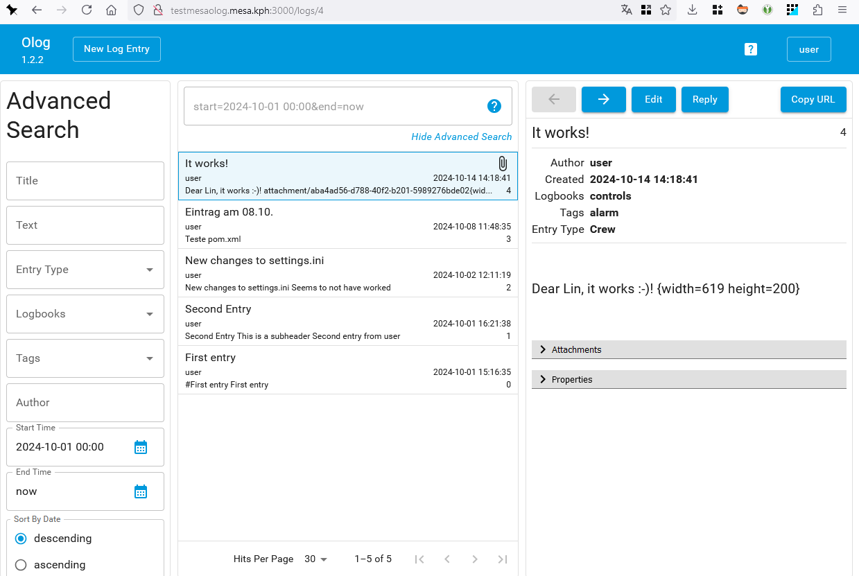

Hello Simon,
I am glad to hear that your Olog web client can connect to Olog service successfully.
I am not sure if the following line in your email is a typo or your actual configuration, but the variable should be REACT_APP_BASE_URL.
2. Writing "ENV REACT_BASE_APP_URL=" to the Dockerfile
Putting the following docker-compose.yml and Dockerfile into phoebus-olog-web-client, which is cloned from the latest master branch, works for me when Olog service Docker container is running in Host 10.1.236.131.

Dear Lin,
Thanks to your CORS-hint adding my webclient to application-docker.properties, I was finally able to get the connection running: (Screenshot)
Still, I need to figure out how to properly get the REACT_APP_BASE_URL environment variable running. Without success I've tried:
