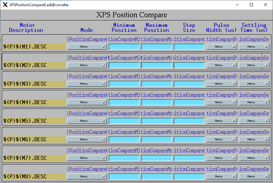

An additional followup about the PCO. I was able to set that up. For everyone's reference, in addition to the parameters in the command that Mark provided it also needs the PREC value for the motor, so something like:
dbLoadRecords("$(MOTOR)/db/XPSPositionCompare.db", "P=18ID_D_Newport:,R=m8,PORT=XPS1,ADDR=0,PREC=4")
Again this seems to load fine, but I get the same processCallbackOutput process write error on iocInit for various PCO values. Further, I can't set the PCO values with the PVs, again I get an error of this type:
2024/11/13 10:47:19.364 18ID_D_Newport:m8PositionCompareMode devAsynInt32::processCallbackOutput process write error
And I've verified through the newport terminal in the web interface that the PCO values aren't changing (the read back values for the PVs also don't change).
Any idea what's going on here?

·     First, how do you set up the PCO PVs? I found the XPSPositionCompare.db file, but there's no example in the sample IOC of how to configure it in the st.cmd file. Do you have an example handy you could share?
I don’t think we have used that from EPICS at GSECARS beamlines.  We mostly use ProfileMove with detector trigger outputs along the trajectory.
You load the database per axis, with either dbLoadRecords or dbLoadTemplate.  For example:
dbLoadRecords($(MOTOR)/db/XPSPositionCompare.db”, “P=13IDA,R=m1,PORT=XPS1,ADDR=0”)
This is the medm screen where you configure 8 axes.  There is also a single-axis screen.
This has not been used much, so if you find problems please let me know.
Mark
