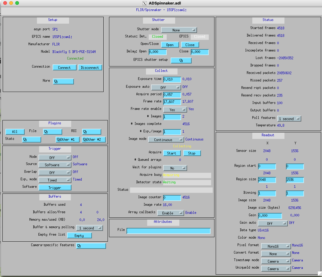

Even after executing the commands to increase the net.core.rmem_max and net.core.rmem_default to 8MB, I saw the same error message. Attached is the image of the medm screen for the camera after I increased the memory variables. I saw the error message twice so far and in the medm screen I see that the Images Complete in the Collect tab are 2 less than the Started and Delivered frames in the Status tab.

Is there more than 1 camera running on this machine?  Can you send a screenshot of the camera screen under the conditions where it is happening.
