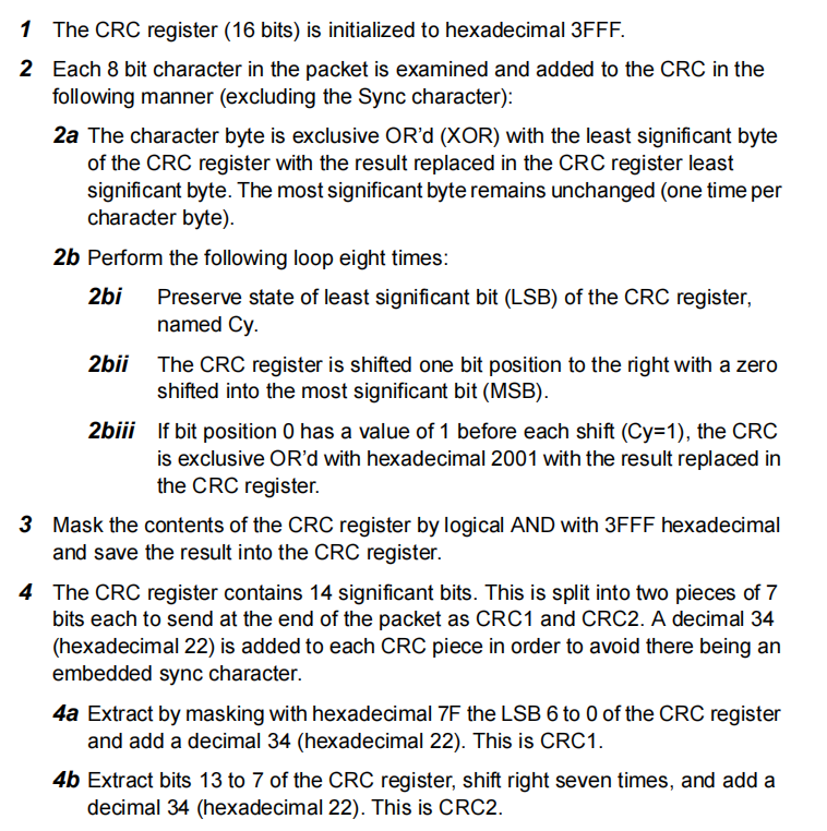

StreamDevice provides some common CRC check methods, such as %<crc16>. However, sometimes we encounter non-standard CRC checks, like the CRC check of the SQM160, as shown in the figure .
In this case, we need to write a function to implement a custom CRC check and include this custom CRC function in the .proto file.
How can we implement this process?
