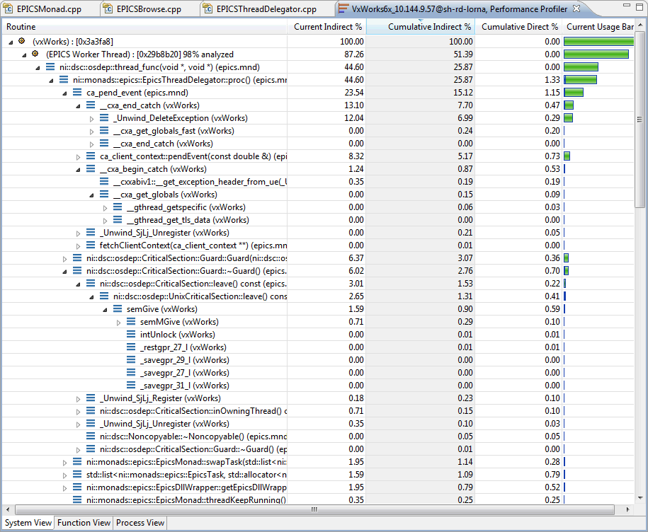

Latest update:
It seems the exception is thrown when in pendEvent(), it tries to destruct the callback guard.
Jeff and other guys, do you have any thoughts?
Let me know.
Thanks a lot.
Lorna Zhang

I checked the result that ca_pend_event returns, and found it IS  ECA_INTERNAL(142)!I also saw exception related stuff in my profiler (attached below). What does this tell us? (All this is based on preemptive callback mode being turned off.)
I have no idea about the  "old file descriptor registration features of the CA Client API" , but I saw some suspicious comments on the function ca_client_context::pendEvent(), which appears in the call stack in profiler. Are they relevant?
I also tried stop/resume thread and check the call stack, I found that it is the first EPICS thread that has eaten up the CPU. It hangs at semMGive(), and before that there's an allocate exception?? For the second EPICS thread, it gets stuck in semMTake().
Here comes the most weird thing, if I add a printf after calling ca_pend_event() to print out the return value of the function, then after deploy a second EPICS client, the CPU usage will stay low, while the return value is still ECA_INTERNAL (before deploy the second one, ca_pend_event() returns 80, which is ECA_TIMEOUT).
Any thoughts??
