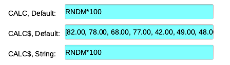

> I am attaching the screenshot of the userCalc.bob file in phoebus, display builder with the Format set as string, Still the problem persists. The moment I change it to just .CALC I am able to enter 36 chars.
Can't duplicate. This is my example record:
# Executed with softIoc -d ... from EPICS R7.0.4.1
record(calc, "test_calc")
    field(SCAN, "1 second")
    field(CALC, "RNDM*100")
The CALC is served as a STRING and works OK with the default format.
The CALC$ is served as a BYTE array, by default displayed as such, so need to set Format do String:
So you have a different release of EPICS base?
Did you switch phoebus to default to pva:// instead of ca://?
