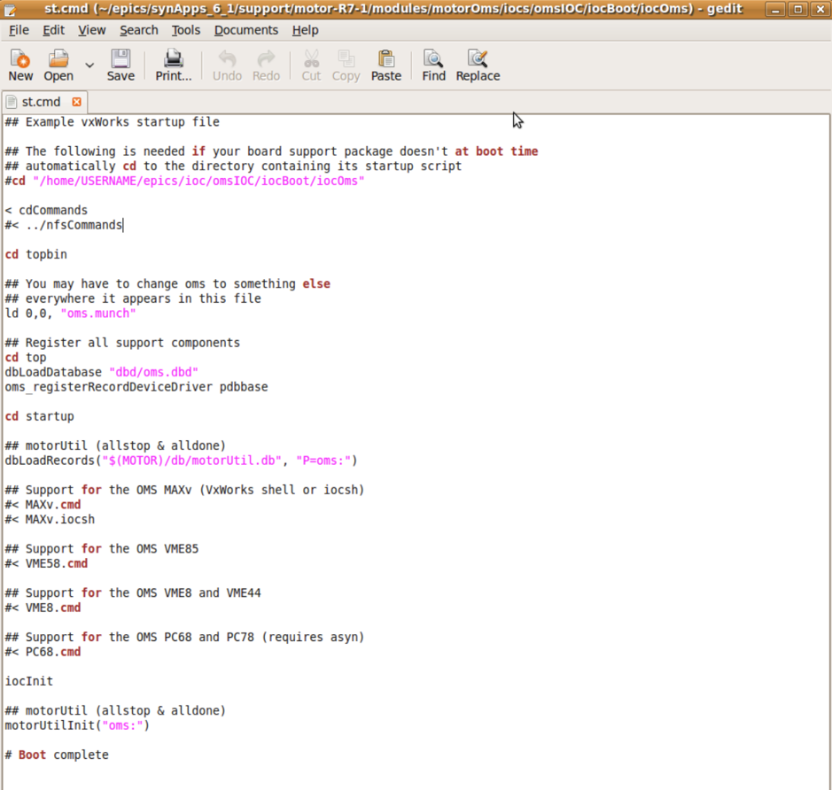

Do I have to modify st.cmd file? I really want to know how to fix this error . please help me.
