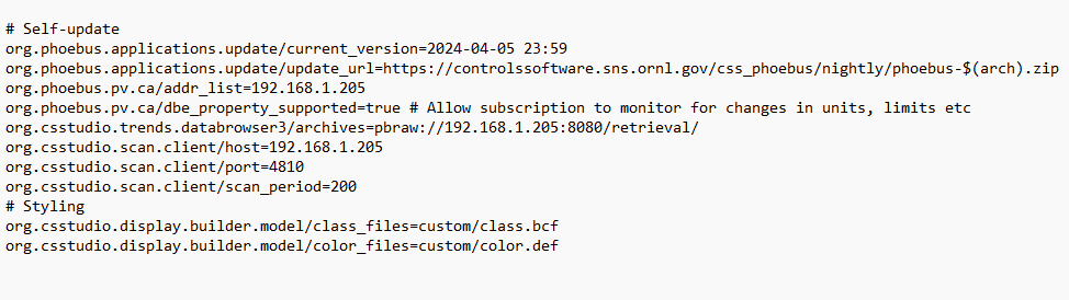

Thanks all for your replies.
Ralph: using DRVH/DRVL instead of HOPR/LOPR indeed solves my issue. Thanks!
Ulrik: please find attached a screenshot of the records I’m now using (I was previously using HOPR/LOPR as you suggested) and one of the Phoebus configuration file. Even though the issue is now solved by using
DRVH/DRVL, I would still appreciate if you could tell me if there’s something else that could be improved in the logic I’m using.
